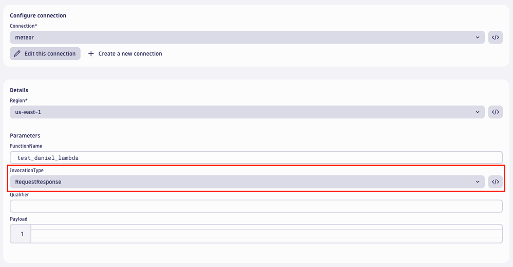

When a Lambda: Invoke Workflows Action times out like in the error message shown, the targeted Lambda Function might simply be running for too long, surpassing the execution time limit of 100 seconds imposed by the AWS Connector.
This can only happen if the used InvocationType parameter in your Action Input is set to RequestResponse like in the screenshot shown above.

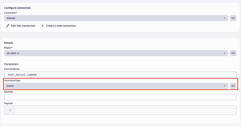

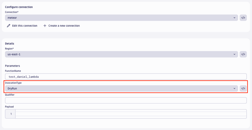

The Lambda: Invoke Workflows Action offers the ability to configure the way a Lambda Function is invoked using the InvocationType parameter. In order to not make the Workflow execution wait for the Lambda Function to finish, you can set this parameter to either DryRun or Event like in the screenshots shown below. Keep in mind that the Workflows Action will not be able to access the result of the Lambda Function this way.
