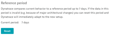

Not sure if this helps, but there's also the option to reset the baseline within a service (vs applying to whole system).
Service -> Edit -> Anomaly Detection
