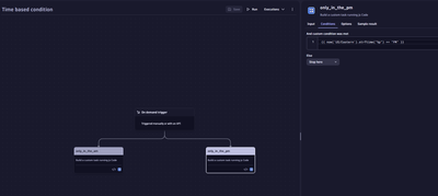

Sample condition:
{{ now('US/Eastern').strftime("%p") == "PM" }}
I'll also attach this sample workflow as an export so can either import it into your tenant and have a look or just look into the definition.
