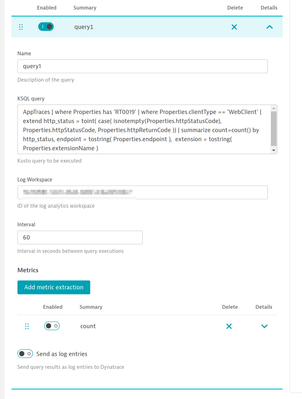

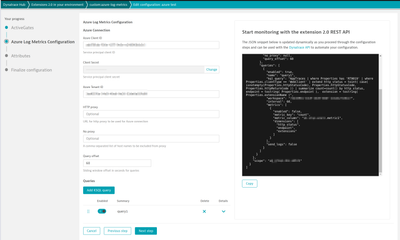

@runatyrIt's an Extension 2.0, I believe you will have a pretty good example in the screenshots:
First you define your azure credentials / tenant / proxy and you can add queries:
For each query you can specify the workspace where this will be executed, the KQL query itself and the interval for execution:

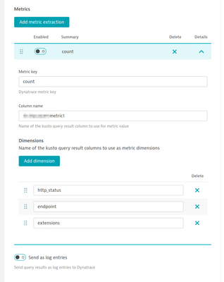

Query itself returns a "table" and you can define metric extraction rules. Extension then creates a Dynatrace metric with the given metric key (this example is from a lab, so the metric key is dummy) and you specify the actual column name fro the metric value. Additionally, you can specify metric dimensions - values from other columns from the KQL result which are added to the metric:

I hope this helps. Basically, data from any KQL response that can be executed in an analytics workspace can be sent to Dynatrace as metrics or log lines. The extension itself uses Azure SDK to access the required Azure APIs.
Would this solve your case?
