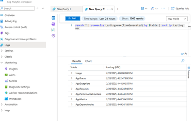

There are lots of options. Here is a query I run to retrieve a list of tables in our Log Analytics Workspace and the last time a log was inserted.
search * | summarize LastLog=max(TimeGenerated) by $table | sort by LastLog asc
28 Feb 2025 04:48 PM - edited 28 Feb 2025 04:51 PM
I think I found the space to run this from... I had to select KQL in the far right.
Is this what you would anticipate?
28 Feb 2025 07:51 PM
yes those are the results I would expect from that query. That query is doing summarization of data. If you want actual log entries pick one of the table names that is the output of the above KQL.
for example this will return all logs from AppRequests for the last hour
AppRequests
| where TimeGenerated >= ago(1h)
