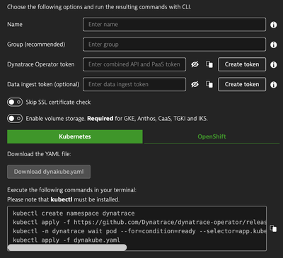

When i deploy the dynatrace operator on my aks cluster following the instructions given to me here:aureliano_buend_0-1693255725292.png
the deployment its succesfull

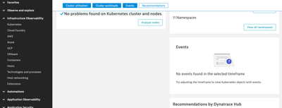

but when i go to my infraestructure obsevability tab on dynatrace to watch logs of my applications there is none, i have configured my logs monitoring like so:

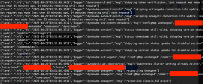

the logs of the activegate agent on my aks cluster are the following:

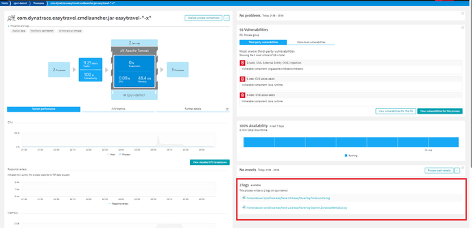

Do you see the dicovered log files at your processes from AKS?
If yes you should use this to define by rules which logs would you like to analyse in the LOG viewer:

i don't see any discovery logs from my kubernetes, but maybe i'm looking at the wrong place

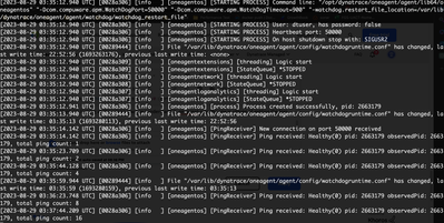

also after a few tries of removing and redeploying the agent i notice that dynatrace its able to get logs for a few minutes and then crashes, after searching in the logs of the pod of activegate i found the following message, i don't know if has something to do with the problem:
[DalWatchClientAdapter] Watching for changes (/api/v1/events) timed out. Will reconnect with resourceVersion='203570': java.net.SocketTimeoutException: Read timed out [Suppressing further messages for 30 minutes
Stream closed EOF for dynatrace/activegate-0 (certificate-loader)
still i think i'm looking at the wrong place as i understand it, oneagent was the one in charge of getting the logs.
Looking at the logs in the oneagent pod everything seems normal to me.
logs of the operator:
everything in the webhook pod seems ok also.
