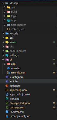

I've recently made the dependencies update of my custom app, with in it the new major version of dt-app. In the new version, there is a new project structure files, so I followed the migration guide of the wiki : https://developer.dynatrace.com/quickstart/app-toolkit/#migrating-from-v0x-to-v1x
When I try to lunch my development app, i've got the error that I have the wrong files structure, but I don't see the problem. I tried to add empty `documents` and `actions` folders, or add a README.md in it but I still have this error :
✖ Building ui...
              Invalid project structure detected
              Your project uses an outdated file structure that is not supported in dt-app v1.0.
              To ensure compatibility and avoid build issues, please update your project structure.

PS : I've also tried to add the suggested build.sourceRoot option in my app.config.json but doesn't work
"build": {
    "sourceRoot": "./"

Hi there,
the solution to this problem is to remove every single "src" in your imports in the whole project. If you have an error with a src/ import in, it would return this error (instead of returning import error I guess)
