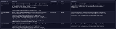

Has anyone noticed this:

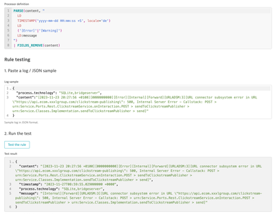

I create a log processing rule to remove parts of the content and only keep relevant data (remove everything after the '[ERROR]' and store it in a new field "message"
The rule works fine when tested, but when applied at runtime it cuts off parts of the content.
Here, querying Grail after the processing has been applied (note the cut off "message" field):
Are there any settings/limit I should be aware of for such cleanup rules?

Hi @r_weber
the LD matcher matches per default the first 4096 characters until the next line break. You might have some wired line break. therefore I would suggest to go with the DATA matcher and specify a higher character limit.
But I would suggest that you try the pattern first in notebooks and see if it works the same way as in the processing definition.
fetch logs
| filter <your custom filter for the relevant records>
| parse content, """LD
TIMESTAMP('yyyy-mm-dd HH:mm:ss +S', locale='de')
LD ('[Error]'|'[Warning]')
DATA:message"""

14 Dec 2023 09:51 AM
Hi @GerardJ ,
I solved it as @sinisa_zubic suggested by adding a quantifier to the DATA / LD matcher like this:
USING(INOUT content:STRING) |
PARSE(content, "
  LD
  LD
  DATA{1,8192}:content
Hope that helps,
Reinhard
