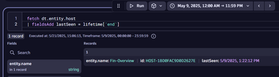

With the above, would you not still run into the same issue?
If you run fetch dt.entity.host over a period where the host hasn't been seen it won't return a result.
For example, if I query during the time my host was last see, on the 9th of May, it shows up:
If I query for hosts on the 10th of May, it doesn't show up because there weren't any:
