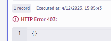

I was trying to access Dynatrace's internal data via Notebook. However, I came across HTTP 403 - Forbidden. I was curious about the root cause behind it as we did not do anything on our end and were still able to access it yesterday.

Hi Philipp,
Some are affected, some are not.
Working fine: fetch logs
Not working fine such as fetch dt.entity.host and my custom query:
fetch dt.entity.host, timeframe:"2023-03-01T00:00:00Z/2023-04-05T12:00:00Z"
|fieldsAdd osVersion, cpuCores, memory = (memoryTotal/1000/1000000), ipAddress, monitoringMode
|lookup [fetch dt.entity.process_group_instance |fieldsAdd softwareTechnologies, tags |filterOut contains (entityName, "OneAgent") OR contains (entityName, "Linux") OR contains (entityName, "sshd") OR contains (entityName, "Short-live") OR contains (entityName, "master") ], sourceField:tags, lookupField:tags
Thanks, @kwangxi for following up. I believe you're missing the permission to read entity data.
You need the
storage:entities:read
permission to execute the query mentioned above.
There were some recent changes to the permission model in the scope of the preview, I'll email you a document on this with further details.
