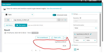

I have added the below Metric “log.Global_txnRef_ID” from “Data Explorer” and I am trying to turn it into “table format” to create a dashboard, But when I run the Query, the results aren't showing in tabular format. Can you please let me know if you have any idea?
