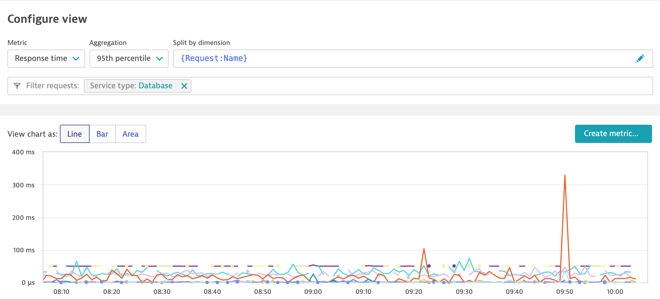

You don't need tag, you can just pick service type, Database, pick 95th percentile agregation to have slowest executions and than you can create metric based on this. Unfortunately there is no 99th percentile or max value.

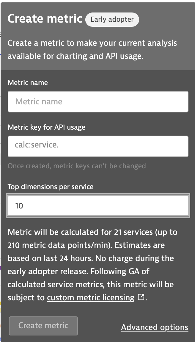

Use button that you can see on screen "Create metric....". After finish the process you will be able to chart it on custom chart. Remember that each DB statement will consume 1 custom metric from license. So if you will have 100 queries, each will be count as new dimension, and each will be consuming license. In such case you will have to use 100 custom metrics from your license.
And my bad, you cannot use percentile and service type as a filter when you are creating metric. You will have to do this via tag or management zone.
you will see there this guy, you will have to pick top X number of statements you wish to monitor. You should be able than to change aggregation on metric itself after creation to see max or percentile.
