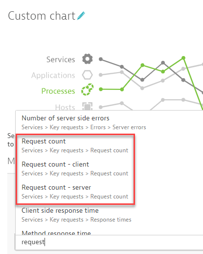

2.) Yes, If you create a custom chart, you can create a tile that contains the following:

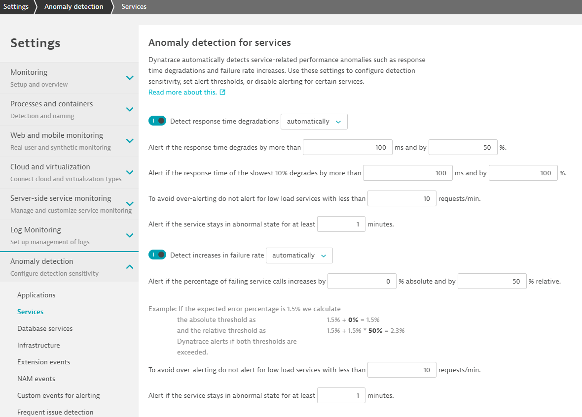

3.) If an entity is set to a automatically let then it will use the Dynatrace AI, Davis, to determine what anomalies will be alerted on. Davis does this by baselining all the previous data from 7 days ago. If CPU typically runs at 20% and then come Friday at 5pm, CPU spikes to 50%, Davis will detect that, compare it to the baseline from the previous days and generate an alert as a 30% increase is a deviation from the baseline. https://www.dynatrace.com/support/help/how-to-use-dynatrace/problem-detection-and-analysis/basic-con...

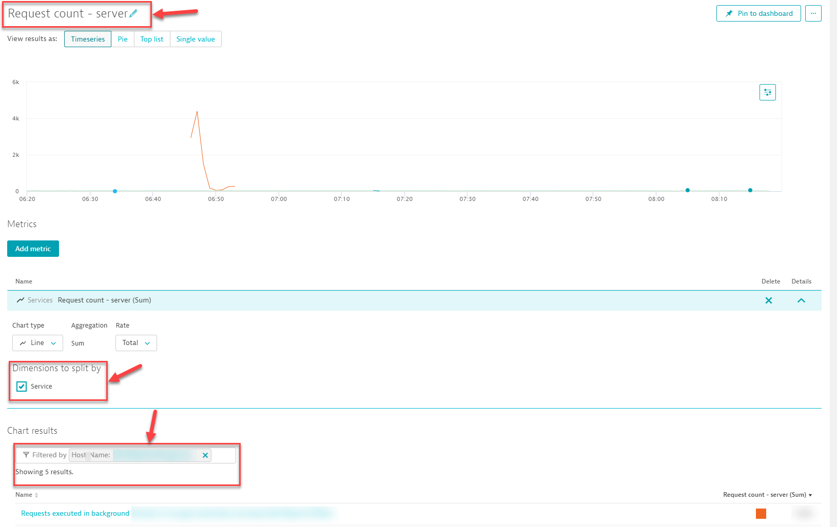

2.) I think what I was trying to ask is that can we split the Request Count by Host? We can see Request Count split by Services and Request, but we cannot see the total number of request that processed by Host. Do we have a metric for that? or we have some alternative to solve this request?
3.) Does that applied to this Sensitivity?
Thanks.

2.) The custom charts wont allow you to split the requests by hosts directly, rather by the services of the requests. A work around for this is to create an automatic tag that, you can call it "Host Name" and the auto tag will provide you with the device/host name. From there you can create a custom chart, looking at the request count, split it by services or keep them grouped overall, then scroll down to the filter and add a filter on the host name and add the host name into the title of your tile:
If you want to alert on this by host, and each host/service might have a different threshold, then I would recommend Custom Events for alerting by going to using Settings>Anomaly Detection>Custom Events for Alerting. From there you can get as granular as you want and alerts will be generated out as static or AI Based.
3.) That sensitivity will result in making the rule you are setting in your screen capture, less strict.
