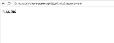

@Julius_Loman Thanks,  for you valuable inputs. I just got to know that our network team setup a public load balancer with the url  https://dynatrace-cluster-ag.....com.sa
which is listening on 443 and the traffic is being forwarded to the port 9999 internally. So  I just queried this loadbalancer from my mobile browser(see the screenshot) without the vpn and without 9999 port, its working, But how can make the mobile application not query the port 9999 after scanning the barcode?
You need to update the URL for Cluster ActiveGate in the CMC. (see my screenshot above)
