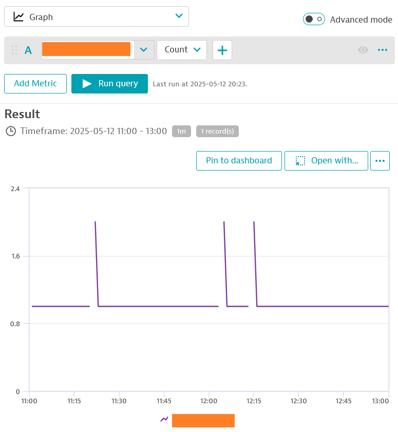

When sending data through the EF2 framework report_metric() function, I experience what I believe are delays in data being sent to Dynatrace. This is viewable in Data Explorer, where the count function shows two data points for some minutes:
But when looking at the extension logs, that shouldn't occur. I have removed in the log below the initial part, and changed sensitive info:

And, it seems that data is only being sent out after 29 seconds...
I normally use to send data through the line protocol directly to the AG, but using report_metric() should be better...
How can I guarantee that data that is sent by the extension is immediately sent to Dynatrace?

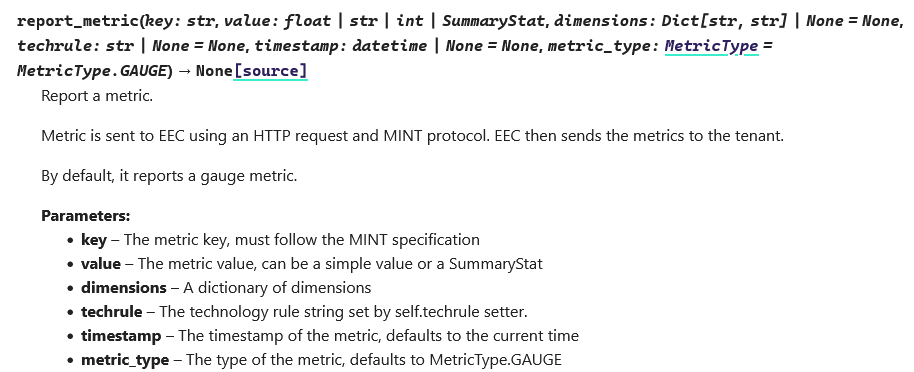

Thanks for the details. In fact, looking at the definition
(via https://dynatrace-extensions.github.io/dt-extensions-python-sdk/api/extension.html#dynatrace_extensi...)
the timestamp shouldn't be necessary. And given the logs above, it doesn't explain why data isn't being sent each minute.
Also, the delay in my case of more or less 29 seconds is also something I don't understand why it's happening.

But, even with the delay of 29-30 seconds every time, you should still be seeing the data points in Dynatarce every minute, as 1 data point would fall inside a minute. In the log, it says it sends every minute yet we see a gap at that specific timeframe.
So, maybe we have the following scenario: you get the ok response but that doesn't mean the metric is accepted in the server. It needs to be processed, and if there is not a defined timestamp it will put the timestamp of the processed time in the data point. That's why I proposed to add the timestamp in the report_metric() method. To avoid any server-side latency that may be introduced. By the way, are the data gaps happening all the time or is it a rare occurence?
