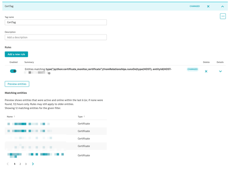

You can select all certificates related to a host with an entity selector like:
type("python:certificate_monitor_certificate"),fromRelationships.runsOn(type(HOST), entityId(HOST-xxxxxx))
Apply this entity selector to an automatic tagging rule, you can get results like:
Would that solve your use-case?
Due to holidays and stuff I didn't had the time yet to review this comment. Just tested it and it works like a charm! Only modification I've done rather than using a HostID I've been using the host tag based on the defined hostgroup.
