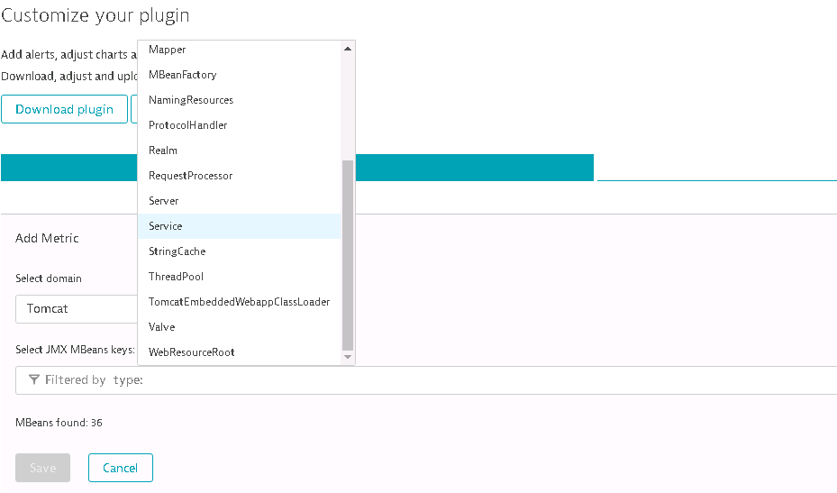

From my experience JMX editor presents all available metrics. Always when I was asking client about preparing some mbean for me, I was able to find it. The only difference is that than you have to find domain, but on those lists you have some generic options sometimes like
When you pick this you will have option to find all available metrics filtered by name. This is how I'm using it.

This is how I could do it:
1.- Use JMX/PMI extension editor. Specify a name,
2.- Click on "add metric source"
3.- Technology: Apache Tomcat
4.- Click on the pencil for the suggested source
5.- Specify a host and tomcat process that you know (verify first) has a service that uses a ddbb
6.- Click "Add metrics source"
7.- Click "Add Metric"
8.- For Domain select Catalina
9.- Now in the filter bar select "type"
10.- Select DataSource
11.- Now, go to the "Select atribute" list, and select maxActive or numactive.
Good luck anybody.
