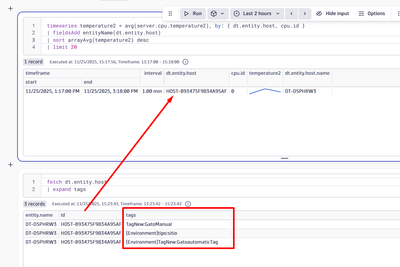

DQL does allow to do lookup and get tag information.
But I am looking for an option to enrich the metric with information that could set proper security context during the ingestion and allow the use of segments in more effective way. This will ensure users get quick access to their metrics and may be certain metrics can be restricted in future as well.
