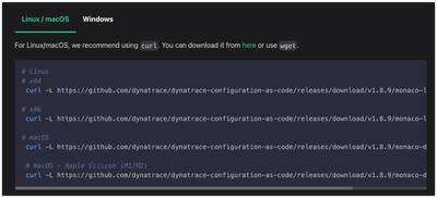

@AntonPineiro
Maybe because v1 is still default and hardcoded in docs)
So everyone who wants just to try - will download the old version.
https://dynatrace.github.io/dynatrace-configuration-as-code/Get-started/installation
