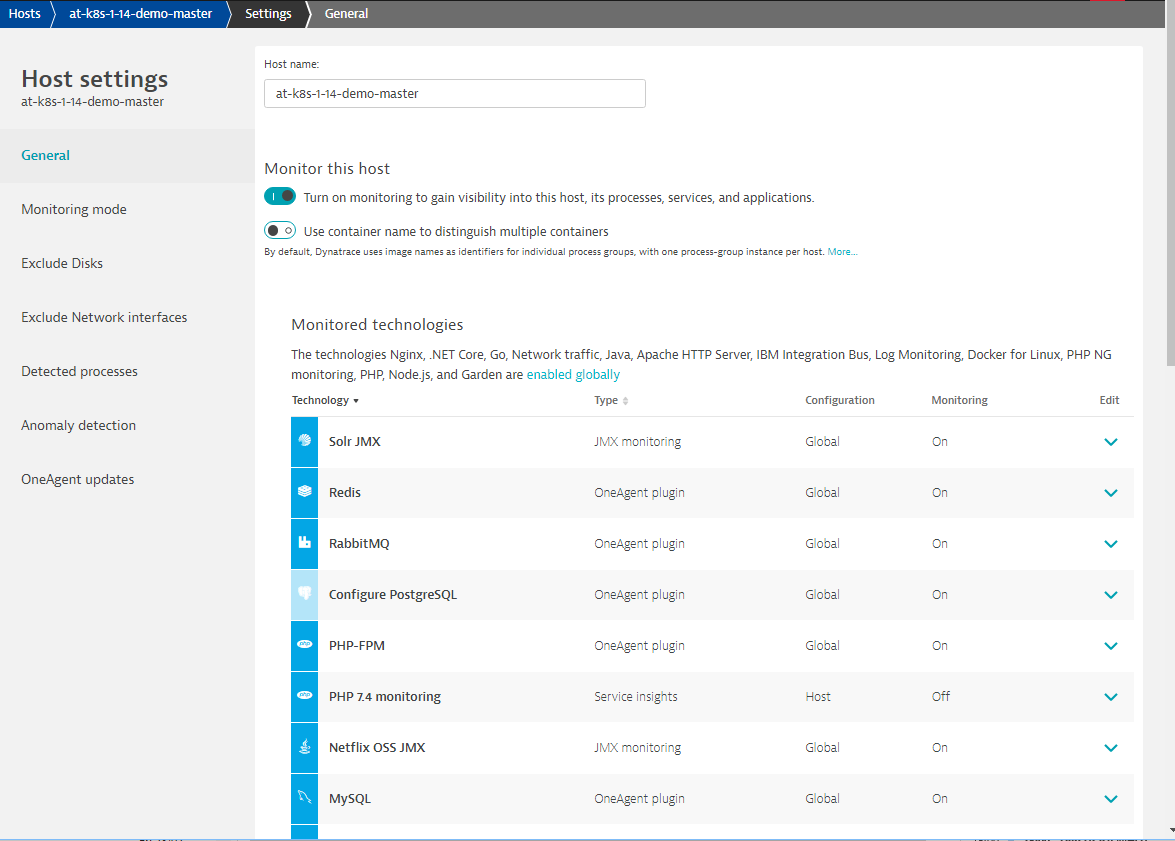

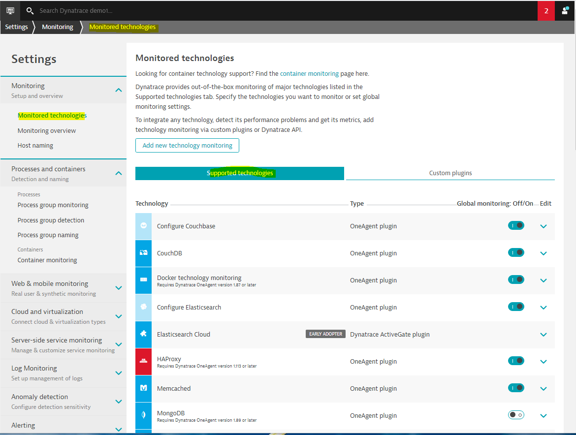

How do I define in Dynatrace which processes to monitor and which not?
Hi @Solomon M.
Globally from settings --> Monitoring --? Monitor technologies
From host perspective you can do that too
