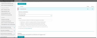

Hi Anton,
regarding process availability, kindly find the configurations below
Thank you
27 Mar 2023 08:29 AM
I understand now, you want to be alerted when some server is decommissioned, if OneAgent is removed, you cannot monitoring process availability because it is done by OneAgent itself.
I think this is not a built function provided by Dynatrace, you need development your own Extension to be executed from ActiveGate.
Best regards
