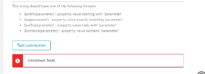

Hello, I am carrying out the Vmware configuration and I get the following error when I perform the connection test-

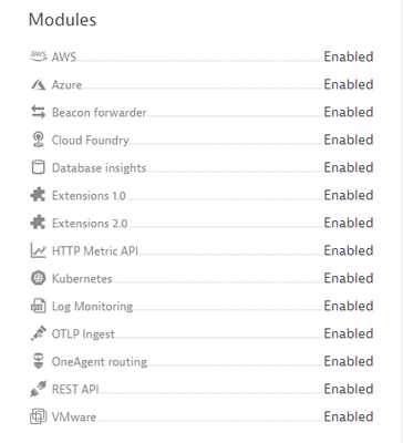

The activegate has the Vmware extension enabled.

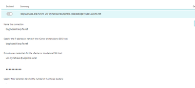

can you share a screenshot of the configuration page in Dynatrace
Dynatrace Certified Professional - Dynatrace Partner - Yourcompass.ca
This is with IP
This is with Name

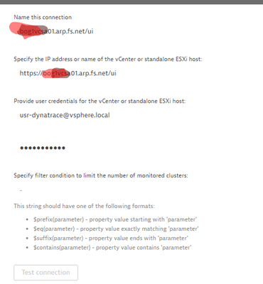

I have to put the https because when I enter the operating system and open the browser to enter the vcenter it asks me to enter the htpp
Islam_Zedan
Champion
can you try only bogivcsa01.arp.fs.net without /ui or https://
andre_vdveen
DynaMight Leader
DynaMight Leader

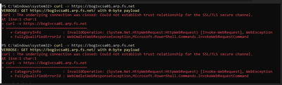

Hi @gabriel_gomez, I think what @Taylor-Sanchez is asking is whether you have only one ActiveGate or multiple ActiveGate deployed at the moment. If multiple, you'll have to determine which one is being used for the VMware integration, assuming they're all enabled for VMware integration, which they should be since that's the default.
The documentation is clear on not adding the http:// or https:// prefix, so please take that off as it won't work when the protocol prefix is added.

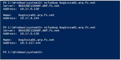

Unknown host indicates name resolution issues to me, or that the host simply does not exist on the network. To verify hostname resolution is working, run the command below from the ActiveGate, replacing <target_FQDN> with your vCenter or ESXi hostname and <DNS_server_IP> with a valid DNS server IP in your network. If the hostname of the vCEnter/ESXi host resolves, then try the curl test; if it does not resolve, then the ActiveGate from which the connection to vCenter/ESXi host is made, is not working due to e.g., invalid DNS settings.
nslookup <target_FQDN> <DNS_server_IP>
You said the connection from the ActiveGate to vCenter was tested via the browser and it works - have you confirmed there are no proxy settings set in the browser? I'd still do a traceroute or ping test at O/S level, assuming ping is allowed, to confirm that the connection can be established outside of the browser. You could use curl and try it using the hostname, the FQDN, and the IP address:
curl -v https://your_vCenter_or_ESXi_host
Also, test connection from the vCenter to the ActiveGate for completeness sake, since the vCenter must be able to send the data back once the connection is established:
curl -v https://your_AG_IP:9999/communication
PS: I was able to reproduce the problem by configuring a connection to a non-existing host e.g., the IP address I used, does not exist on our network, or is not in use. I also get the Unknown host error, so perhaps triple-check the hostname/FQDN/IP address you used...typos do happen! 😉

3.
4.

Based on the outputs of those commands, you seemingly have a network connectivity problem between the vSphere and ActiveGate, which you'll need to resolve.
