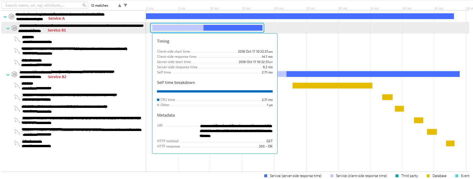

In the chart below I am referring to light blue bar.
4. How should I proceed with analyzing the root cause of client side response time?

For example, if we have Service A that calls Service B1 and Service B2 like on the screenshot:
In this case, the client-side response time for Service B1 is 14.7ms:
Sorry for bothering you, just wanted to be sure about this, because it is important for performance analysis.
17 Oct 2018 04:58 PM
I spent some time thinking this through and I am trying to confirm some of this but let me put this out there as it makes sense based on the the more I look into examples.
So in your example, the client side response time is 14.7 ms because from when the client service A called B1 the response time of B1 was 14.7 ms, but B1 only saw it should execute after a number of ms and from when it actually started to when it finished was only 9.2 ms - the rest of the time in the light blue bar would be something else upstream. A self time of 2.7 ms says to me that is how much time was actually spent in the code for B1 itself (the rest looks like DB activity).
Does that make sense? Thanks for noting something didn't seem correct.
17 Oct 2018 07:08 PM
Hi James,
Thank you for quick response.
I think I got the your point about client-side response time.
The only thing that is still a little bit unclear to me, is relationship between client-side and server-side response time. It is logical to me that client-side includes server-side response time.
So, from my example 9.2 ms is included into 14.7 ms, and there is 14.7-9.2=5.5 ms lost somewhere (traversing the network or something like that).
But if you look at the chart from my example, there is some inconsistency there:
So, based on topics above, client-side time will finish before server-side time which is strange to me? In this case client-side time should finish at the same time like server-side ~ 10:30:37.626 (or 18 ms from start), so duration of client-side response time should be ~17 ms.
Do you see some wrong logic here, maybe I missed something?
17 Oct 2018 08:58 PM
I think I see what you mean and I can't explain that - first thought is that with such small levels if there's any rounding maybe it gets funky. Regardless, I'm gonna look into it more as I want to understand it better as well.
17 Oct 2018 09:11 PM
Thanks for your help. I will also try to find the answer for this.
17 Oct 2018 09:15 PM
Just got some possible explanations - if these services are on different hosts it could be as simple as a time sync issue. The start times you see there will be server time and with such low times it's possible that is if they are slightly different you can see anomalies like that.
If the services are on the same host though the recommendation I got was to open a ticket so it can be investigated. Regardless, I'm pretty confident the general explanation I provided is correct but will update if I find anything new.

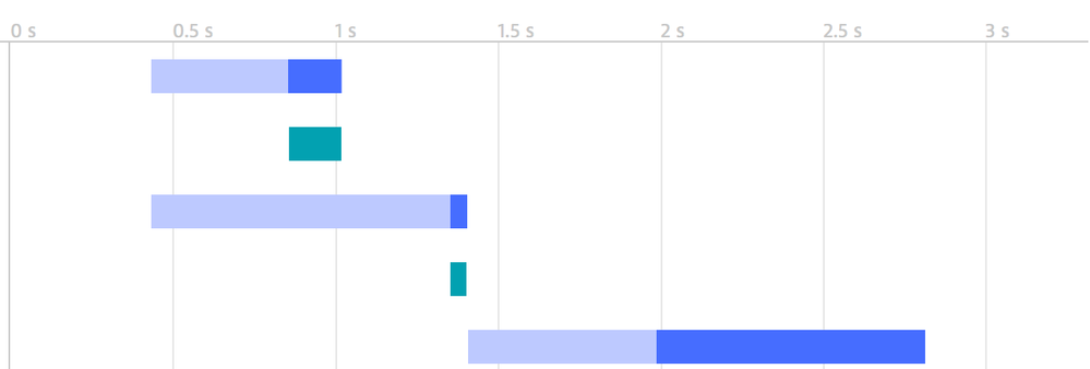

Hi all
Here I have interesting PurePath with big client-side response time between services, which are running on one host on containers. I cannot explain such big numbers. Can anybody help me please?
23 Aug 2019 02:08 PM
Hi Vlad
Please see exemplary explanation shown here https://www.dynatrace.com/support/help/how-to-use-dynatrace/services-and-transactions/analysis/purep...
"According to the example above, most of the time of this particular request was spent on the client side of the getLoyaltyStatus
web service call. As indicated by the colors of the bars in the chart, the time was not spent on the server side of this web service but rather on the client side. If we were to investigate this call further, we would find underlying network latency. "
23 Aug 2019 02:31 PM
Hi Janusz
I can understand if client-side RT is before Server-side RT as @James K. wrote here
So any client-side time at the beginning is time from when the client service called the service to when the service began executing
But I cannot understand then client-side RT is at the end just right after server-side RT and the services are running on the same host in docker containers
