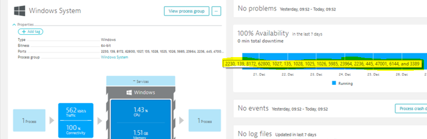

Hi all, just realized that I might also has to answer customer's question on this later in near future.
Any new idea or discoveries? The way I see it I can only customer based on port number (for example in this screenshot I know 3389 is for RDP)
But then, I am not quite sure this way of looking at the listening port number is a verification approach or identification approach. It most fellow community member also get these ports numbers in their environment then we've got our answer.
Do you need to split the processes on the listening port? This won't be possible as the process detection happens actually before the application even starts and listening sockets are created by the application itself.
