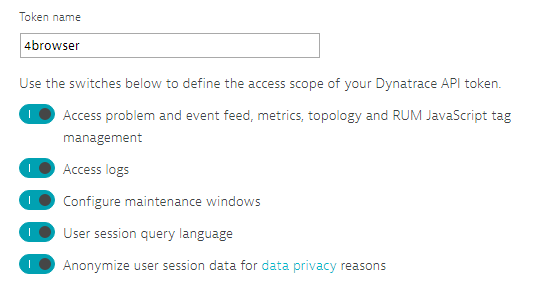

Hi @Dante P. thanks for your reply.
Odd, for me its keep returning that I have no RumBrwoserExtension permission while all the switches on this API token are on
May I ask what is is your DTM version? here its 1.152.153
Yos

27 Sep 2018 06:06 AM
Still not working for me also with the revision=0 getting 403 😞
Will open a ticket on this one and will update ASAP
Thanks for support !
