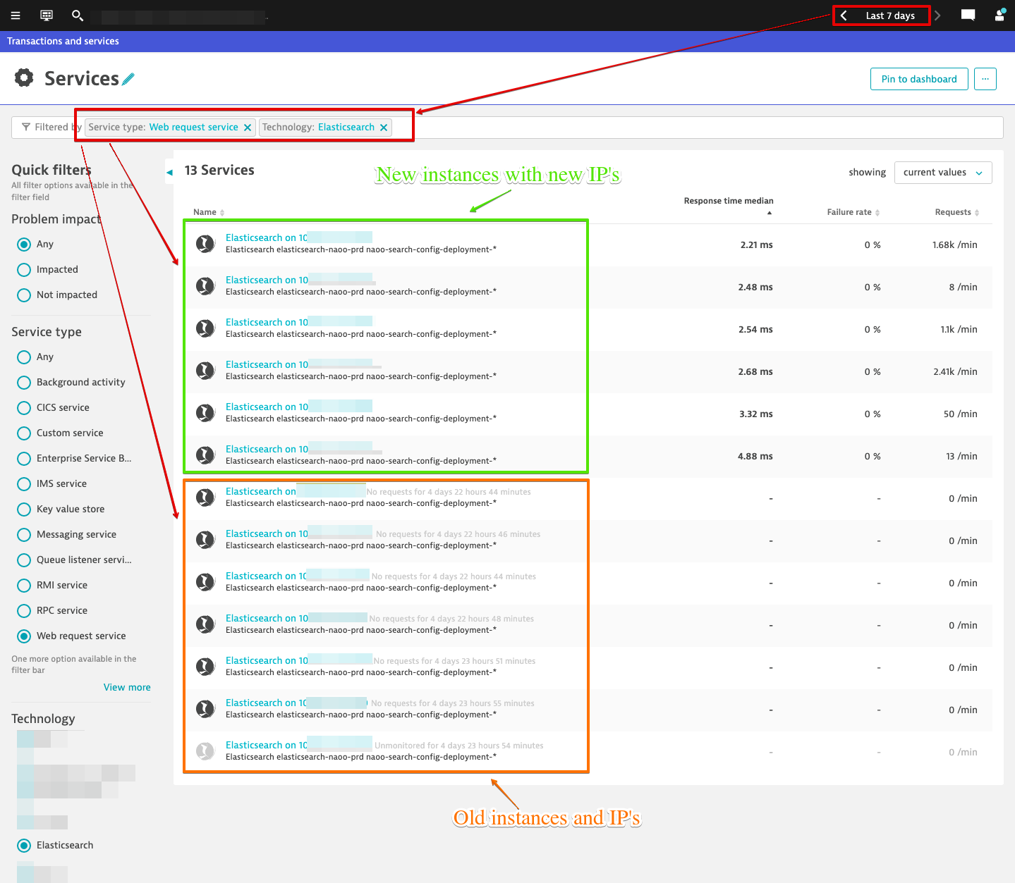

One of our teams is running on GCP using Kubernetes and has the same Dynatrace problem raised daily which is a "Response time degradation". We have been trying for weeks now to figure out how to isolate specific requests so that we can fine tune the anomaly detection around them.

IP Changes
The IP for the Elasticsearch services change anytime there is an OS update and / or Kubernetes update. Because key requests are configured at the service level, it is then lost once instances go away and new ones come in.
The name of the Elasticsearch service is always "Elasticsearch on <IP>:PORT" in Dynatrace. This is an easy fix through service naming rules which I later did, however that still did not provided any added benefit.

Then of course there is service merging. That too is a great feature until you come to this type of situation. You can merge all day long, but as soon as those instances go down and new ones come up it is back to the drawing board. There really needs to be a configuration option to allow for auto-merging for this approach. I have created an RFE on this approach which I have provided a link to below.

Service naming rules only change the 'friendly' name that you see but the underlying entity will still have the same ID hence it's easy to have things named the same way but there will still be separate logical services.
Service merging is OK in some situations but at scale and in cases like this it is not super helpful which is why it is being replaced by 'service detection rules' that allow you to tune how services are detected. Can't see from screen shot because the properties exist in the service overview page but services are typically detected from combinations of three properties: application ID, server name, and context root. The service detection api rules let you apply conditions and then transform or override these values giving you complete control over how services are detected even before they show up in Dynatrace. Keep in mind though that services can't span host groups/process groups so this assumes they are all part of the same ones.

Since the underlying issue is the service detection this should resolve the request naming rules, but also note there are global naming rules you can set through the API.
This was exactly what was needed and perfect timing for it. Thank you!
