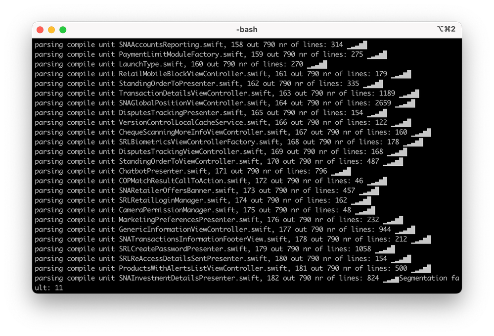

We have an issue at the moment to generate the iOS Symbols for Mobile Application Monitoring.
The last and previous version  of dynatrace-mobile-agent-ios crash with an error Segmentation Fault: 11.
The crash is consistent from colleague's Mac and mine.
Do you have any idea what could be the issue?

Hi!
First glance implies this is a crash caused by a stack overflow from a recursion. As we need more information to debug such crashes please open support ticket at https://support.dynatrace.com/ and provide the following Info, so we can reproduce it.
  • crash report
  • original dSYM file you tried to process
  • Xcode Version
