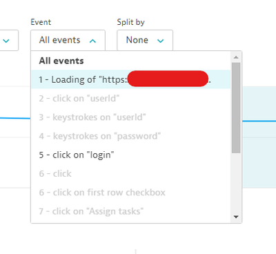

Hello, I have a browser monitor with several clickpath events. I defined my key performance metrics as:
Load action: Load event end
XHR action: Response end
My clickpath events consist in loading the page, sign-in and redirect to the app. In the app I want to monitor an action, let's call it assign a task. This action is a patch request and then the table refreshs (2 get requests).
I want to monitor how long does each action take, but in the multidimensional analysis when I click on event, the only events that are being monitored are the first loading and the login that redirects to the app, my actions inside the app are not being monitored at all:
Please advice!

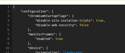

Please can you enable Capture performance metrics for pages loaded in frames in Advanced setup of browser monitor settings and  enable disable-site-isolation-trials in chromiumStartupFlags in browser monitor script mode, as described here
Hello Hannah,
Still the same. I made a new browser monitor with the changes you mentioned and I can't see the other events.
All I want is the see the events like in the docs: Number of actions consumed by browser clickpaths - Dynatrace Docs. And after login, Dynatrace ignores the events.

And I have 4 more browser monitors that have exactly the same type of events, and not one event inside the app, after login, is being monitored.
