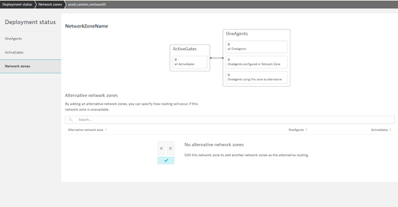

  • Network Zone with no ActiveGate or OneAgent looks like below :

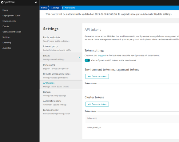

  • To get an API-Token with the ServiceProviderAPI scope, go into the CMC of the Cluster under Settings then to API Tokens. Click on Generate Token under Cluster Token, give it a name and enable ServiceProviderAPI for the access scope.
  • The new generated token should now be able to authenticate for the deletion REST API endpoint for Network Zones. Which you can use to delete the network zone.
