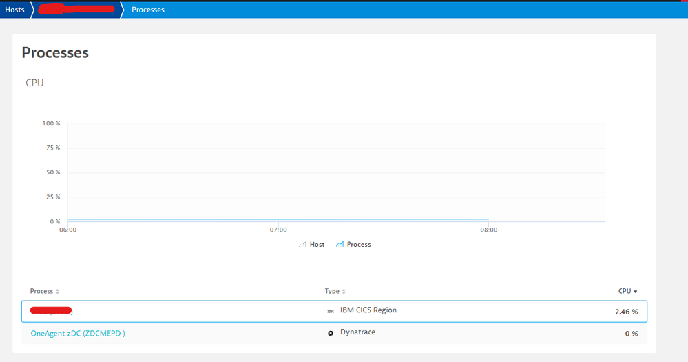

  • Go to the affected host (Hosts> Click on affected host)
  • Click on All Processes
  • Click the OneAgent zDC. You will be re-directed to a different screen

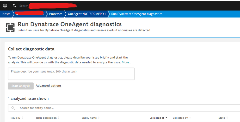

  • Click on the 3 dots on the upper right
  • Click Run OneAgent Diagnostics
  • You can then start the collection of the logs by clicking Advance options > Select 7 Days and Store Locally

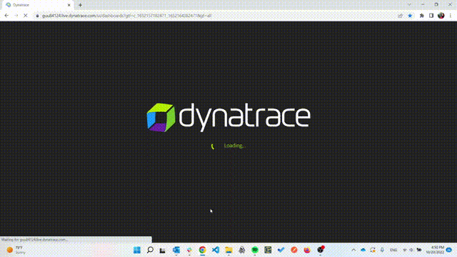

Watch the full process:
The zip file that you will collect contains logs from the zRemote, zDC and zLocal. Please attach it to your ticket and inform the support engineer. This will help them greatly.
