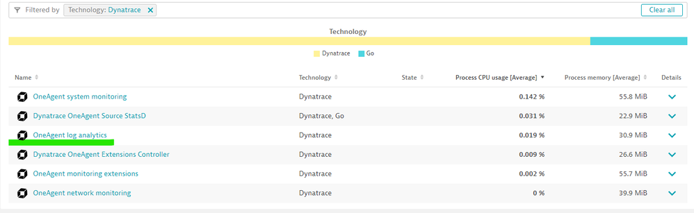

  • Check if the Log agent is running in the host; you can check by going to the host page -> Process analysis section- Filter by technology Dynatrace and see if the Log agent is running.

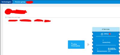

erh_inetum
Champion
Hi @noel_david ,
Here an example: for this kind of rules
we have seen that if the process group doesn´t have deployed services
the log isn´t captured. But it is in case the process group has deployed services.
Please, let me know in case my explanation is not clear and it try to explain it better again.

erh_inetum
Champion
Hi @noel_david ,
The screenshots that I put in my comment below are the issue we had and how to reproduce it.
We haven't opened a ticket because we configures the rule for an specific host and we got the log.
Let me know if this information os enough.
