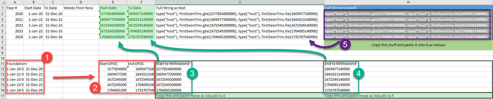

How to use the Excel File:
Step 1 - I supply the Day, Month, Year and time for EST Time Zone and I put that into a batch converter for EPOC time. This can be access via this link.
Step 2 - Take those EPOC times and paste them in the columns.
Step 3&4 - Excel will convert them EPOC time to Milliseconds take those, cell values and paste them above, but make sure you paste them as values.
Step 5 - With the Millisecond times supplied, Excel will create the entity selector text. Once again you will need to copy and paste this content but paste it was values.
You now have the entity selector string (but we will make one minor change later). The same method is applicable for all tabs in the excel workbook.

So as a result, our string says to look at the first time seen 'later than or at the specified time' (GTE). Since this statement is forward looking and somewhat endless, we add another string to look into the future past by saying First time seen 'Earlier than or at the specified time' (LTE). This is essentially telling the system to look at January 1st at 00:00 and look forward from that time frame, this forward looking continues until it it's the past looking rule to then say look backwards from February 1 at 23:59 which basically traps the rule to be contained in Jan 1 - Feb 1.
One other limitation at this time is we can only do this for one entity type at a time. So yes, you will need to formulate the set of strings for host, then copy the strings and do a find/replace of host with service, and process group instance. But we will get to that a bit later on.

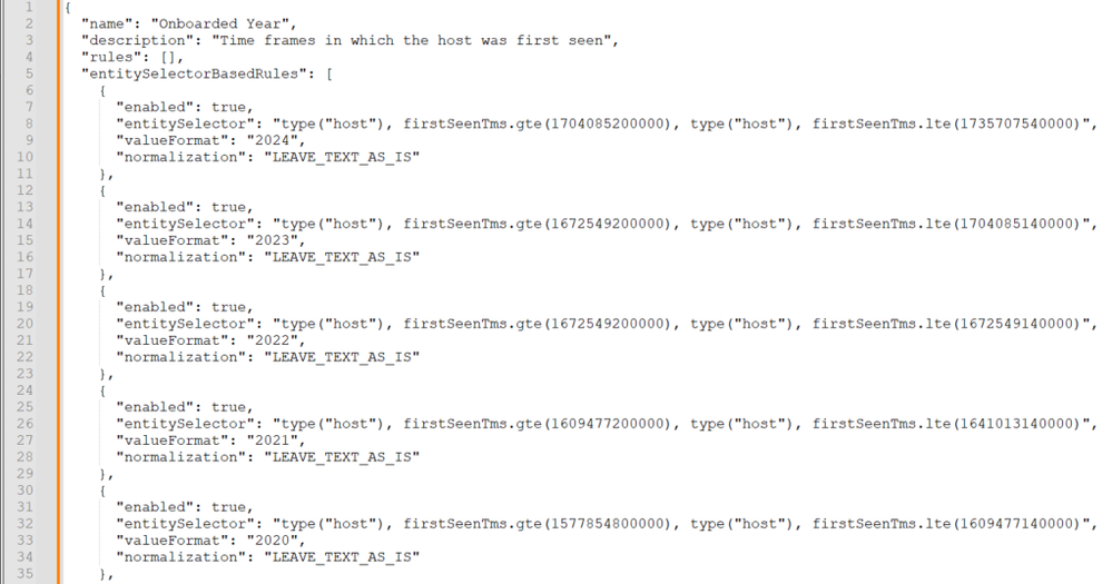

Setting up your JSON for Auto Tag posting via the Dynatrace API.
Now that we have the excel sheet completed and we have the main set of strings for our time slices of Week, Month and Year, we can start to compile the Json. I personally like to use NotePad++. You can download this for free online if you do not have it already or you can use a text editor of your choice.
First, we need to add in each rule which calls out the time frames via the string excel set for us and we will then define the Key and Value Pair for the tag.
Sample:
"enabled": true,
"entitySelector": "type("host"), firstSeenTms.gte(1704085200000), type("host"), firstSeenTms.lte(1735707540000)",
"valueFormat": "2024",
"normalization": "LEAVE_TEXT_AS_IS"
You will notice my rule is set to true, but my entity selector is targeting Hosts from January 1, 00:00 of 2024 to Dec. 31, 23:59 of 2024. And the value those entities will get is "2024". It is quite simplistic but you'll need to paste and update the value per set of years you want. I am targeting 2020 - 2024.
Once completed your set of strings should look like this:

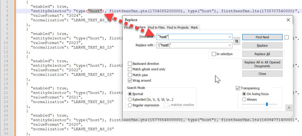

Now remember as I mentioned above, the entity selector will only target the first type of entity supplied in the string - trust me I have tried to combine multiple, and it will not tag anything but the first defined entity type in the string. But that is not a big deal, we can just copy the rules you made. So, I am going to copy lines 6 - 35 and paste them into another page of my text editor.
With lines 6-35 in another page, I am going to select "host" and do a find/replace. I am replacing "host" with \"host\".

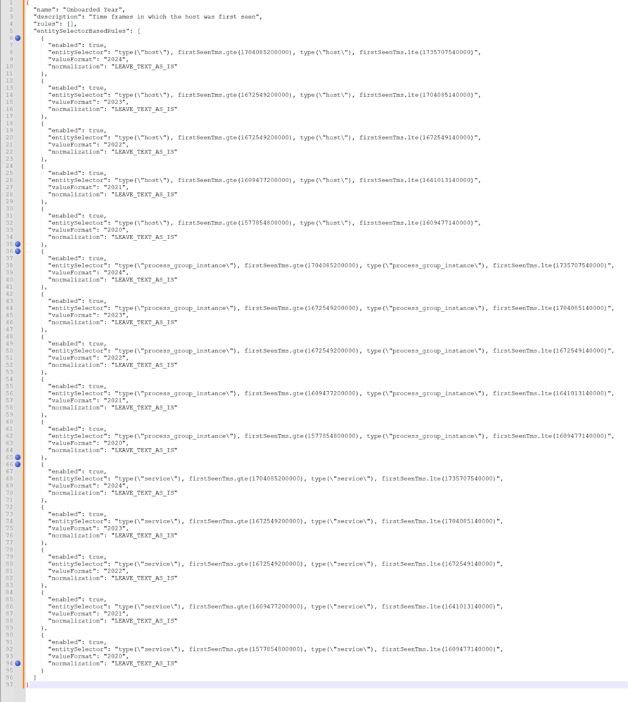

Hit replace all, and you just completed the tags for hosts, now let us copy all those lines and paste them back into the original sheet that will be our API posting JSON. Keep in mind, we need to do this now for service and process group instances. So, let us repeat the steps. Since I still have the lines 6-35 on another page, I will just jump back over and do another find and replace and replace the \"host\" with \"service\". Copy and paste all those lines over to your main Json page and repeat it once more for Process Group instances. So, I will find and replace the \"service\" with \"process_group_instance\". copy and paste that over to the main Json page. you should now have a page that looks something like this. (I put the blue dots so you can see the end/start of each entity type sets.)
You will do this for each time slice that you are going to leverage. It's important to note that you are limited to 150 rules in each tag set by default. So, when you go to add in weeks... 52 weeks in a year, X 3 entity types = 156 Rules 😞 6 rules over the limit. So, we decided to split the time into a half year via Q1-Q2 and Q3-Q4.

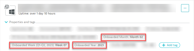

As you complete the Jsons go ahead and post them into your environment via the Dynatrace API: Configuration API>Automatically applied tags>POST New Auto Tag. You will need a valid Dynatrace Token with write access.
You can also use the Jsons I have compiled. just note, like Dynatrace, I drop out granularity over time so you can only target the weeks in which an entity was onboarded during the current year and previous year., after that you only have Month and Year.

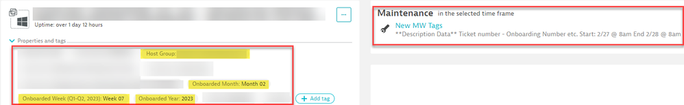

Here is what the tags look like once completed:

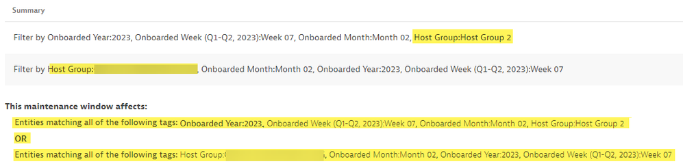

This can be done via the UI or API, however you want. in the UI you will open a new MW and fill it out as desired in accordance with your organization’s standards for MWs. Now at the filter section you will add in the tags as you see fit. Keep in mind we have several types of time levels, we have Weeks, Months, and Years. You can use all three, or you can drop each one to get a broader timeframe. So, if you team has a year to complete the app and will be onboarding things over the year, just include the Year of 2023. This method also applies to month, onboarding over the course of a month, add in that month. All the way down to the smallest time frame of week, stating it will be onboarded in Week 5 out of the 52-week year.

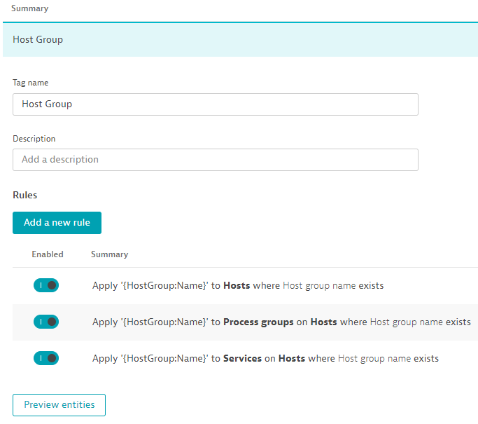

These tags alone are not enough to isolate your MW to select entities. Your time frame tags apply to all entities in the environment. So, we need to build one more tag if it is not present already, Host Group Name. you can do this right in the UI and is extremely easy:
Since Host Groups are unique, they also have a Dynatrace ID, so for Host Groups that haven't been created yet you can't target them until after they exist. So, we will use tags since we can define a tag in the MW even if it is not present yet.
Once the Tagging Rules are set let’s Revisit the MW and add in your Host Group Key: Value Pair with Tags.
You will want to add all of these on one filter as it allows you to use "AND" in-between the tags. So, the entities in which this MW applies will be entities with tag: Host Group:EZYTRVL AND Onboarded Week: Week 05 AND Onboarded Month: 02 AND Onboarded Year: 2023. So, the entity must have each and every one of those tags otherwise it won't be included.
If you add a new filter, it will use AND in the string as above, but it will but an OR in-between the two rule filter sets. Which can be extremely useful if you have several Host Groups in which this should apply to.
Here is an example:
Make sure you set your start date and time for your MW. It does not have to be right on point but needs to be earlier then when the entities go live as the MW will only apply to entities once they show up and meet the filter criteria you supplied.
Do not forget the end date and time, this is the most critical as that is when the MW will stop and should be in line with the Go-Live Date/Time so alerts can be generated, and integrations triggered for team notification.
Result:
