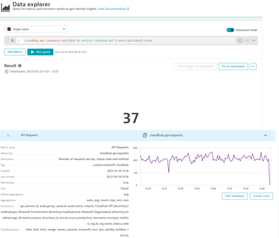

Hi @Erica_Oliveira2 please check if you have info in this metric:
24 Apr 2023 05:57 PM
Nothing appears, because it does not capture the Apis.
