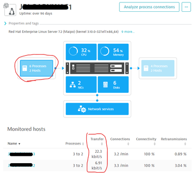

I would like to visualize traffic between hosts with OneAgent installed. As shown in the screenshot, traffic between hosts is displayed as "Transfer". Is it possible to display this value as time series data in a graph with Data Explorer? I tried looking up the metrics, but I couldn't find any relevant metrics.

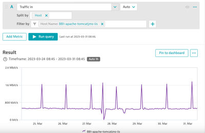

You can use this metrics with splitting by host:
  • Traffic in
  • Traffic out

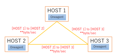

I think there is a problem with my question and I confused you. sorry.
What I want to investigate is that there are three hosts "1", "2", and "3" with Oneagent installed, and traffic is generated from each host to host. As shown in the figure below, I would like to visualize the traffic on a host-to-host basis and create a time series graph.

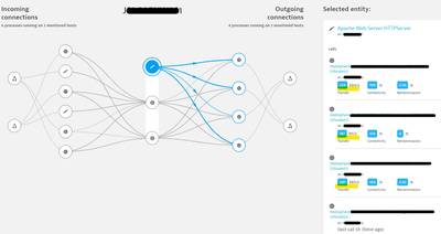

You have Analyze process connections but this is for processes instead of hosts, just in case.

"Analyze process connections" is also interesting. You can also see Process to Process traffic as seen in this screenshot. I would like to be able to express Process to Process traffic in a time series graph as well.
T.Shirai IIM Corp. Osaka Japan
Hi @Shirai and @AntonPineiro
I don't know if we can fully meet your expectation at Dynatrace. What I would do is, export these metrics outside of Dynatrace. Then based on them I would build the appropriate visualizations in Kibana or Grafana for example. Alternatively, I would write a piece of code to show me these dependencies based on the metrics from DT.
