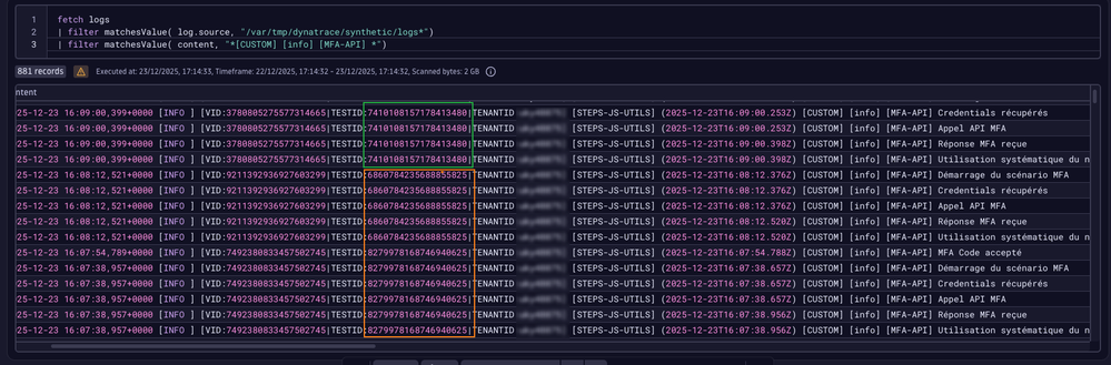

Hello @HannahM
I would like to leverage the execution logs of the synthetic tests to perform statistics based on these custom events (api.info) for each synthetic test.
I can detect my custom events by looking at the Synthetic Player logs, but there are no attributes to identify the synthetic entity related synthetic testID.
For example, below is a log entry:
How can I map the testID with the dt.entity.synthetic_test related to it ?
Thank you for your help.
